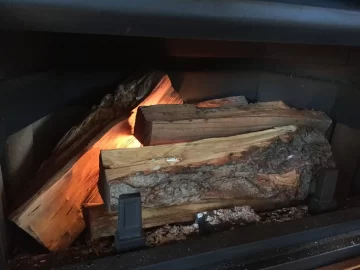

How do you guys load your inserts? east west? Or north south? 99.9 % of the time I load east west however I came across few short cut splits and I loaded it north south and I kind like it better. Better use of a fire box tighter fit, make me wonder if I will get a longer burn. What do you guys think? Is it worth it extra work when you cut your wood?

If you are reloading and you have a small bed of coals and stove cooled off already try to do first layer N/S and then E/W. From my experience if can load the stove E/W full that will be mine longer burn
