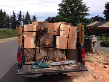

Ok guys, How do you get those huge stumps/trunks up in the truck?
[Hearth.com] How do you load your truck?
I know I'm not Superman (Weenie armed pecker neck really...) but some stumps of oak I've cut that look like this weigh what must be 800 lbs. Holy cow! Is there some kinda pickup loader thingy you built to load up? Or is everyone but me just that ripped? :D
I'd love to bring home logs of that size and saw them up at my convenience instead of having to make 18-24" lengths out of them just so I can lift the suckers!

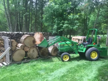

If you're going to process big wood, you have two choices. Take your saws and splitter with you to process them on-site (which is what I used to do), or get a front-end loader capable of moving them. BTW, those FEL's you see on cat-0 sub-compact tractors are not capable of moving the sort of stumps you're discussing. That's cat-1 CUT minimum territory.

I say just cut them to length before loading if you can. I had been grabbing a lot of log length stuff (4'-6') little by little and built up about 3 cords worth over the winter. But it makes quite a mess in the yard when you are cutting that much wood. I have limited space for processing, so I have decided to make the bulk of my mess somewhere else and then bring the cut wood home. As far as the pic you posted, pieces like that can be lifted so that they are standing on end and then top end can be laid onto the tailgate. Then pick up the bottom end and slide the piece into the bed. I have used that method a lot in the past. It always seems to be harder to get them out than it was to get them in though

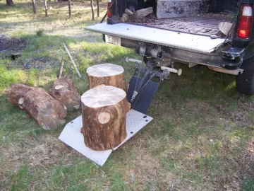

LOL! that crane is pretty neat, but I could see it bending my pickup box real bad. That other thing on post 17 is exactly what I was thinking!
Here's a direct link
https://www.hearth.com/talk/threads/pics-of-your-toys-work.161802/#post-2175904
And a pic:
I invited Montana to stop in and let us know about it. Hopefully he'll come say hi!

Hi GadDummit, thanks for the reply.
I purchased this from Northern Tool for $499 plus about $100 freight here. http://www.northerntool.com/shop/tools/product_650281_650281
They have them listed on Amazon for $392 plus $50 shipping. https://www.amazon.com/dp/B000FAKNM0/?tag=hearthamazon-20
They are rated for 500 lb. I like them because they slip right into a 2 in. receiver hitch with no welding or drilling. Having said this, I did have to do some modification to it. The motor/winch that it comes with does not work well in my opinion. It has limit switches that kept malfunctioning.
So, I took it off and purchased an ATV winch and installed it. It took some doing to fabricate a mounting plate for it, but I have that capability in my large shop. Once I had that good winch on it, it has worked great for several years for me.
As I have said elsewhere, I am 71 years old, and without this I would no longer be able to cut and load firewood.

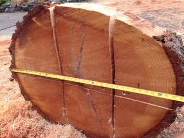

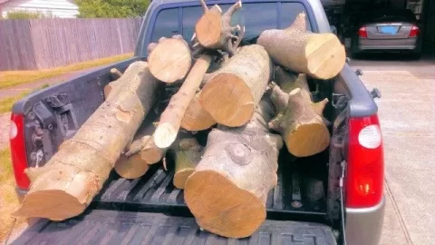

Don't try and lift it all at once. 36" is easy peasy. Here's a 40" or so round at the end of the log that I took apart and hand loaded in a couple of minutes.

I'd "like" that photo, if it weren't for the off-color saw.

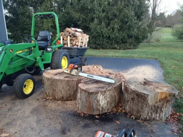

Here's some 48" - 49" diameter x 20" long rounds I brought home whole, with the help of a grapple on an excavator, and a dump truck. I think each weighed close to 1500 lb.
Note proper colors on the saw. ::-)
