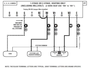

I have a Lux TX1500U Programmable/Manual Digital T-Stat. I works for millivolt systems or 24 volt systems.
What must be done with the Lux T-Stat to make it work? The specs in the Quad Santa Fe manual state it will work on a 24 volt system.
