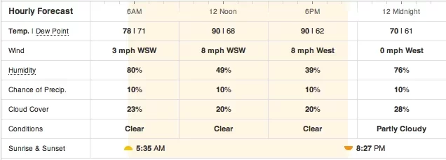

Still, in most areas of the country, rising daytime temps have the effect of lowering the RH somewhat. Below is a table of today's forecast in my area. RH begins at a not too shabby 80% at 78º at 6 AM, will drop to 49% as the temps climbs to 90º by noon, will get even lower at the same 90º temp later in the day (indicating that drier air is expected to move into the area), and will rise to 76% at 70º by midnight. Since the RH at a midnight temp of 70º is actually expected to be lower than the 6 AM RH at 78º, this is a further indication that drier air (i.e. lower absolute MC) is expected to move in later in the day.

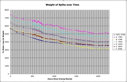

The drying experiment I did last winter was meant to try to establish a drying curve that would allow one to predict the time that the fuel would be ready based on weight data only. I discovered that, after the initial fast-drying period of free water leaving primarily from the end grain, the drying curve closely resembled an exponential decay function. Funny thing, all anybody seemed to get out of that is that I was trying to convince folks to skip outdoor seasoning entirely and dry exclusively in the basement. Whatever...
Skyline (on a couple of recent threads) has done an outstanding job of taking this idea into a real-world outdoor drying situation. His curves are very similar in shape to the ones I generated, even though they have a lesser slope because he isn't drying his wood at the 20-30% RH I had in my basement. By taking accurate weights at regular times and using these weights to determine a rough constant of proportionality, you should be able estimate within a month or two when your wood will be at any desired MC in your area simply by using an exponential decay formula.
