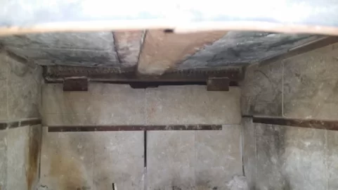

If you have been following my threads I have encountered a draft problem and smoke coming back into my home.
I just pulled it all apart and swept it up to the cap. Some stuff came out but nothing I would say is a fire hazzard.
The cap is clear I can see all the daylight nothing stopped up there.
Attached is a picture of the inside of my stove. I guess I don't understand how this thing works. I gather my problem is in the stove itself. Let me know what shape you think it's in and what I can do to improve it. I did notice there is one broken firebrick on the top that wasn't there before I started burning.
Where/how does the smoke exit???

Is it a good idea to go through and poke all the holes with a nail? I know they are for gasses returning to the stove. Whatever that part is called it doesn't look to be in the best shape...but it's solid.
The smoke exits up the chimney.

Previous owner did not have the bricks in per the manufacturers instructions....and it makes total sense it was destroying the natural airflow of the stove as there is about an inch of space supposed to be left between the front row of top bricks and the stove. I must admit to being excited to be on this track. I have the bricks in correctly and am going to put everything back together and give it a go. Thanks everyone!

Some of these bricks have to be cut the long way...that's going to suck if/when the time comes!
Why would you need to cut any? If the previous owner just had them in wrong shouldn't they be OK when installed properly?
Are they the original bricks?
I don't know if they are originals. Two were broken but they were the full sized ones. In the top span of bricks there is two on each side that have a width smaller than the standard size. I don't have to cut any as those bricks aren't broken....but some day they may need to be replaced.

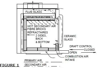

I put the user manual in my sig the bricks for this stove are on page 12.
Thanks for adding it to your signature. That's saves guesswork. The secondary looks similar to Napoleons.
Yes, they are similar. Don't know if Napoleon has the tube on the back.
