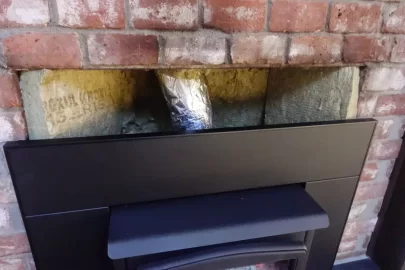

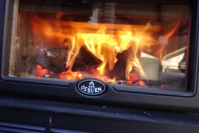

I had the Osburn 2400 Insert installed last week, everything went smoothly.The only hiccup was the custom surround was damaged and the installers are having their people redo the surround. They are scheduled to come back this week to install the surround. I followed the break in procedure to season the stove and have had the opportunity to have a few good fires. I installed some Roxul insulation since my chimney is an exterior chimney and will install a block off plate some time next week. I just want to thank everyone on this forum who take the time to offer guidance and advice to beginners such as myself. I have learned a lot in the process and and look forward to learning more. I have attached a few pictures of the insert, let me know how it looks and if there is anything that needs to be changed etc. Once again many thanks to everyone!
I'm getting a security alert when I try to post pictures, how do I post pictures? Also, more importantly as I stated before I placed Roxul insulation around the insert/damper, and now am getting a funny odor from the insulation. Should I be worried?
Finally figured it out :) [Hearth.com] How far can a fireplace insert stick out? [Hearth.com] How far can a fireplace insert stick out? [Hearth.com] How far can a fireplace insert stick out? [Hearth.com] How far can a fireplace insert stick out? [Hearth.com] How far can a fireplace insert stick out? [Hearth.com] How far can a fireplace insert stick out? [Hearth.com] How far can a fireplace insert stick out? [Hearth.com] How far can a fireplace insert stick out? [Hearth.com] How far can a fireplace insert stick out? [Hearth.com] How far can a fireplace insert stick out?
