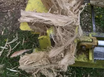

    I can do it in one stroke of the ram: :coolsmile:

    Yes Jags, I'm sure when that stuff dries it will work well, but I'm betting you still have to let the ram go all the way down to split that stuff. We have some here that looks just like it.

    Or even drop in another log, just to continue the cutting of the strings. ELM! :coolmad:
