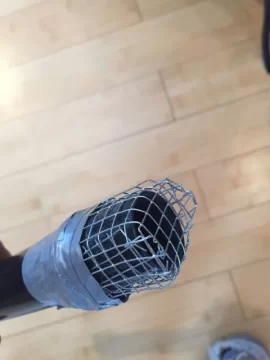

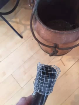

I've used mine about 2 full burn seasons. I made a slight modification to it, to overcome the only shortfall I've had with it. The hose can get clogged with just the right sized bits of burned wood. It does great on ash and smaller stuff, but if it sucks up marble sized stuff watch out, hose can clog.
So I used 23 gauge 1/4x1/4 hardware cloth and put on sort of a guard. Working well.
