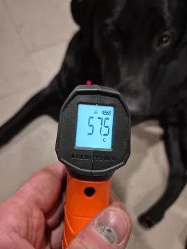

Floor under my jotul f400 does not get higher than 90F, The fire resistant carpet about 12"-16" in front of the door glass gets the hottest. It tested 125F yesterday after running 24/7 for weeks.
My dog lying on that spot tested 142F last year.

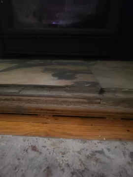

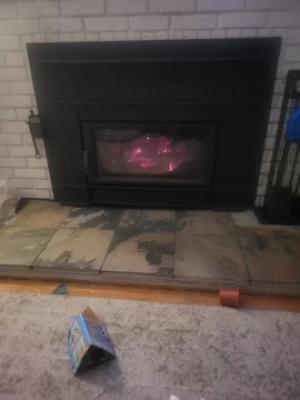

It's a Regency Hi500. Hearth is Slate tile on top, 1/2" durock, 1" of Micore 300 and a 3/4" sheet of plywood. Below the plywood is the original concrete hearth.

I haven't done the wood trim yet around the extension but ill post some photos. I can say as stove temp drops during the burn, the extension temps drop with it, doesn't seem to be holding heat.

Thanks for the detailed shots. This illustrates the value of following the hearth insulation recommendation by the manufacturer.
The temp definitely gave me pause I did overshoot their R value minimum a bit so I was hoping to be in the clear no matter what.
I am curious, the sweep who did the install was very new to this model(despite selling Regency specifically). I wonder if it's possible to install the blower upside down and so its blowing the heat more directly on the extension? Not sure.

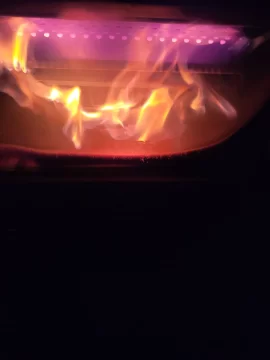

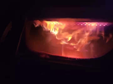

Don't think so, my Enviro stove's secondary tubes have glowed red with normal stove top burn temps (400-650 deg). Nice looking insert, stay warm...

Looks like the cat behind the flame shield is glowing. If so, that's normal.
