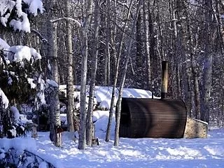

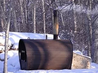

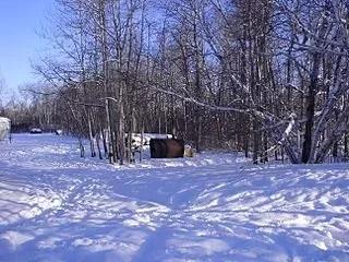

I realize I'm heating with a different type system. I fired this Beast up some time in late October and just keep adding birch.
Yesterday evening about 5 I tossed in half a load, 18 hours later the Beast is still breathing fire and pumping 160 degree
water. Have yet to remove any ash this winter thats why I can only get half a load down it's throat! Low last night was
12 below F. and calm, heating a shop/barn at 45F. and log shack 70F. total area over 4500 sq feet. I have also had a fireplace
burning in the shack since Christmas, more for pleasure then efficient heat I would think. Most mornings I just put some pine
on the embers and away she goes for the day! :-) With this operation, where there's fire there's smoke. Never had any complaints,
closest neighbor is three miles east. :coolsmile:
