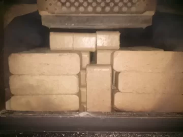

I started with a few, and later in the season when I got more comfortable with them, worked my way up to 15!! Just be sure to pack them together with no gaps, so they burn as one big unit. If you leave gaps you are asking for trouble.

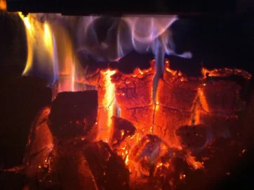

I put 76 lbs in my Blaze King! It's not really recommended, by BK. Don't try this at home!
I got 50 hours before adding any hardwood!

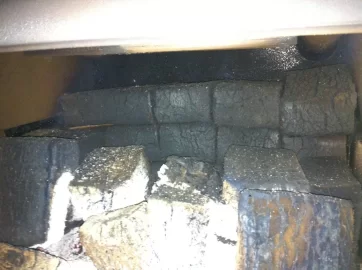

I had 126 lbs in my Blaze King, thirty-six Eco-bricks. I had room for more, but this arrangement was actually too tight. I had to spread them out a little so they got more air, plus they swell some as they burn.
I only did this because I had burned some in the past and knew how they acted in my stove, and the BK is completely controllable. Plus, webby did it :) . I didn't get anywhere near 50 hours, but I was burning them hotter.

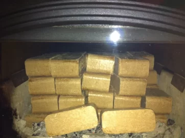

I ran 13 bricks in the Castine. The fire was quite predictable and provided a good long burn. They were densely packed as per directions. I wouldn't hesitate to run several more in the T6 with it's squarish firebox. It's all in the loading.
