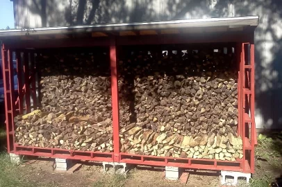

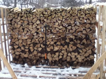

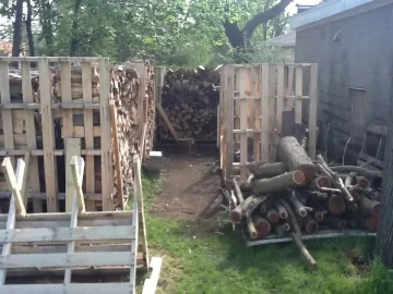

Around here I figure 5 cord to be on the safe side although we used barely any last winter. Try to get a few years ahead if you can ! You can get it off the ground by using long poles or pallets and stacking on them they do not even need to be treated. I have a small amount of property however I use pallet bins such as these to fill with wood and use a small amount of space. You can use 4*4 pallets for this. I can fit between 1 and 1.5 cord to a bin depending on the split sizes. Most Home depot or lowes even just a factory will have pallets for free that you can take if you ask for them. I get them from work and sell them because we pay to have them removed. It can't hurt to ask around for them. Even a well built shed could go a long way. My red wood shed holds 2.5 cord and it is only 4 ft deep. There are tons of wood shed pics here that you can get ideas from and best of all they look nice without a huge footprint That is if your not ogyDave ;lol. To be fair daves look amazing but they are definitely big thats a good thing :).
Good luck
Pete

Great pics Pete and love the pallet wood shelter! Great way to build on the cheap!
Ray

I do have access to lots of pallets and would like to be able to stack higher, will the wood dry as quickly stacked like this?
-Joe
