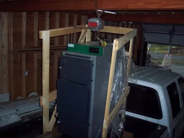

Never looked at your profile just your Avatar. I worked on the Queen of Nanaimo before and been into Sturdies bay many times.
  • [Hearth.com] How much did your install cost?
