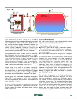

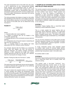

Here is a link to the journal dealing with wood fired concepts. Pages 34-37 talk about the formula for sizing buffer tanks.
http://www.caleffi.com/sites/default/files/coll_attach_file/idronics_10.pdf
And a screen shot of the formula.

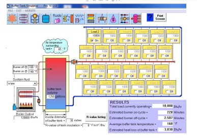

There are also buffer tank simulation programs available, some online. This allows you to toggle loads and change operating conditions and get results with one click.
This is a module from HDS program at www.hydronicpros.com. May be a free demo there?

I think a lot has to do with the load being drawn from the buffer. Mild day, low load is what I tried showed above with a 10,000 btu/hr load on a 1250 gallon tank 180- 140F operating range..
On a design day the boiler may run full speed, about 165,000 btu/hr output at 80% efficiency, just to cover the loads and not add any to the buffer.
