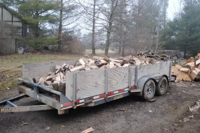

I've got zero ways to prove or disprove any of it, just reporting how I see it. Here is a picture of a cord of wood on my trailer.(16x7x2) It was stacked before I loaded the trailer so no guessing that it's a cord.
Looks and sounds about right .. I sold thousands of cords of wood . Not stacked. I averaged 230 -250 cubic feet per full cord of split wood averaging 15" long. Years of selling wood with 0 customers complaining that they were short changed. When I 1st started I would stack it up and then throw on the truck to get the average.
