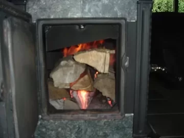

Here's how I load my HI300.. no problem throwing heat. Do you have a blockoff plate or insulation in your damper area?

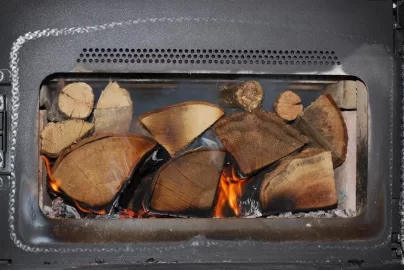

Great pic stejus. I too load her up to burn. Never less than three at a time so that they have friends.
