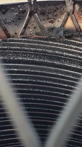

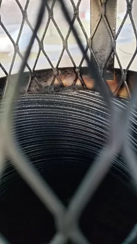

How does this look?

An 1/8" of buildup is the guidline it doesn't matter what that buildup is. But clearly spot is better
