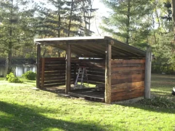

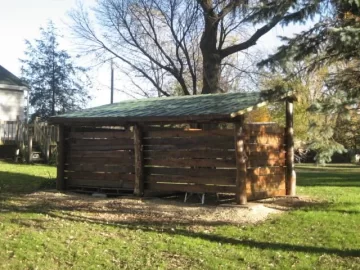

I used this as a rough plan to build my woodshed.
After going through last winter...I was so glad I constructed this!
(broken link removed to http://www.woodheat.org/firewood/woodshed.htm)
I tried to go as cheap as possible.
Using re-cycled lumber, standing dead-no bark trees for post and beam construction.

Sharp looking woodshed, it has a nice nice rustic look to it. I have some old barn material that would work perfect for this application. :-)
That is a good idea.
The bigger money spent was on the roof. I couldn't find scrap tin.
I would think barn material would have a endless supply of materials needed. I purchased slab Red Oak for the sidding. It cost me $50
