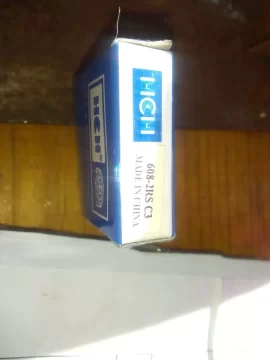

And is this the correct bearings?
Weird thing, when I ordered the listing said "Manufactured in Germany". This box says "Made in China".
