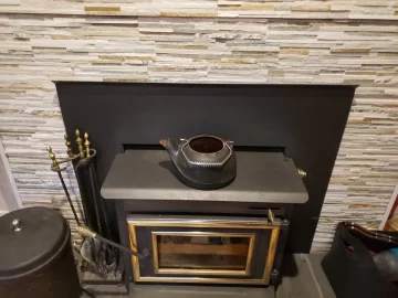

I've recently acquired my first house, and with it, my first wood burning stove. It's an Englander 24-JC, and has a catalytic converter. The chimney is in the center of my house, so from what I can tell, there is no easy cleanout door.
I am thinking that the catalytic converter needs to be removed, so that when I climb on the roof and brush the flue, the creosote will be able to fall into the firebox, then I can scoop it out. I've looked up the manual online, but I can't really find any directions on cleaning past how to actually get to the cat converter. I can probably figure out how to remove it, but I'm not sure if that would be the best option.
I'm thinking it would be best to just hire a professional chimney sweep to come and do my first cleaning and show me the best way to clean my particular stove/flue. Is teaching the homeowner how to clean the flue themselves something that a chimney sweep would normally do? Should I expect to pay a little extra to be taught how to do it myself?

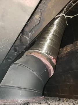

In case it helps someone help me, I pulled this faceplate thing off so I could see how the stove connects to the flue
[Hearth.com] How to clean an Englander 24-JC/sweep the flue [Hearth.com] How to clean an Englander 24-JC/sweep the flue

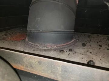

If I were to just sweep the flue, then I'd expect any creosote to make it down that slight bend and then build up on the cat converter.
Pretty sure I just need to take the cat converter out of my stove as part of cleaning the flue? It did not look like it would be easy to disconnect the flue from the stove back there.
View attachment 270766 View attachment 270767

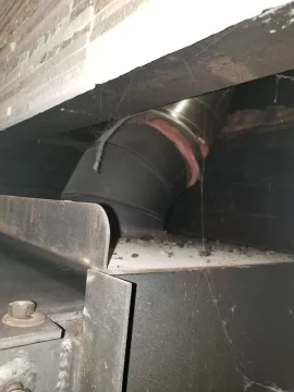

That liner hookup is not correct at all. You can't use black pipe to hookup an insert. That looks like fiberglass insulation stuffed in the joint. The creosote flakes ontop of the stove make me think the flue was not cleaned properly. And several other issues
So that makes me want to get a professional out here ASAP haha. However, I think I may have just done a bad job taking pictures.
The previous owner was generally very good about doing things the right way from what I've noticed.
The black pipe is part of the insert I believe. It connects to what looks like a stainless flex pipe which you can see just above the pink in the picture. The pink is not actually fiberglass insulation, at least not the fluffy stuff that goes in walls - it is hard, so maybe it is hardened fiberglass like the stuff boats are made of?
The creosote flakes onto of the stove did seem odd to me though.
It looks like you are a chimney sweep yourself? My main questions were: Is teaching the homeowner how to clean the flue themselves something that a chimney sweep would normally do? Should I expect to pay a little extra to be taught how to do it myself?

Ok so in that pic I can see it isn't fiberglass. It is burnt hightemp silicone. That doesn't belong there. The black pipe is a standard steel adjustable stove pipe elbow. That doesn't belong there. The stainless fitting above the black elbow looks like it is upside down and isn't the correct type for your liner. The liner looks like it is uninsulated. And there is no block off plate.
And yes some sweeps will tell you what to do

How bad would all these issues be?
I'm generally a curious person, always wondering why, so I'm wondering what the right way of doing all this would be, and how big of an issue these things really are. That stainless steel elbow looks like it belongs there, but you say it doesn't- why?
I read the owners manual again to see if it mentioned not using an elbow there, or the need for a block off plate, and it does not appear that they are mentioned. Is there a resource(somewhere on here maybe?) That goes over all this stuff?
I definitely plan on having a pro come out to check it out, I already tried calling one actually. I'm also thinking it would be beneficial to know what you(or some online guide/general consensus) think should be done differently, why, and how much it matters, so I can compare that to what the local sweep says.
Because it isn't stainless it is just steel. It needs to be stainless because it is concealed.
Using an elbow is fine if it is stainless and if it is installed properly.
A block off plate is not required by code or for safety. But if you want the heat in your house not up the chimney it is very helpful.
The connection to the insert needs to be done with the proper type of stainless connectors installed properly.
The old flue needs to be checked to see if it was cleaned properly.
You need to find out if that liner is insulated. If not it needs to be pulled and insulated.
A block off plate is not required but is definitely very benificial.

Slersner I basically have the same stove but mine is a free standing stove vs insert! Once you get that thing burning, let me know how it does. On mine I had to flip the air intake 180 for it to burn everything inside. The way yours is now(to the right) mine would not burn anything down the right side of the firebox, like there was zero air going down the side! Was so bad the creosote would build up on the door and literally run down the door and would build up on the edge of the gasket! Since I flipped it over it no longer does that and I’m burning 15% wood moisture. With mine flipped over it burns completely across very well!
I've been using it here and there since the previous owner had used it for years and the home inspector didn't say there was anything wrong, though I don't think he removed the faceplate to see how the flue connects.
You're talking about the slide damper above the door which allows in more/less air? On mine, having it to the left is all the way open and if I go much further to the right than where it is in that picture, then there is too little air for the fire.
I havent had any issues with anything not burning. If I cut off the air supply too much then it dies down, but I can play with the left 3/4s of that dampers movement to adjust the flame size.
I haven't figured out if it's best to load wood north to south or east to west in this stove, can't find any recommendation in the manual and from what I can tell it doesn't seem to matter.
I do scrub the glass every few days to keep it nice and perfect. Doesn't take long to use some ash to scrub it clean.
Yes I’m talking about the air damper! I flipped mine to the other side of the stove so it is by the door handle(take 4 screws out and flip over). I can run mine a little lower than you have in the pic, I put a thermometer above where the cat is so I know when it “lights off”! Since I’ve flipped air damper I no longer clean the glass, it stays fairly clean now. I load both ways(north/south East/west), east/west will slow the burn down some to burn at a cooler temp for me or I should say it slows it down on the climbing temp. I have zero smoke out of the chimney no smell just a little water vapor is all. I want to order a cat probe but haven’t yet. It’s a good stove heats very well for me and is the heaviest stove I’ve had at the farm yet. You will not find much info on these stoves. There is a member on here that works for englander maybe he will chime in for a minute. Good luck

It is not an old recommendation at all. You have an interior chimney so to meet minimum safety standards you either need 2" clearance to combustibles from the outside of the chimney. Or you need an insulated liner. That has been code since the mid 80s and still is. And yes this has absolutely been tested and confirmed that heat transfer without those clearances can ignite adjacent combustible materials.
I would ask your sweep to cite the change in R1003.18 that now no longer require clearances or a lining material rated for zero clearance. He will not be able to because that change has not been made.
