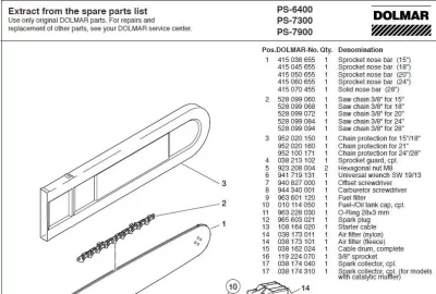

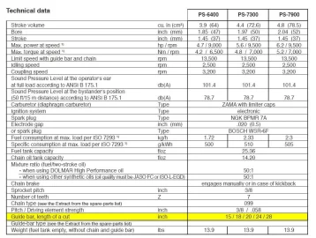

mhrischuk said:
The manual says the max is 28". I guess people do it anyway? The moderators on here may not like that.
Hmm, my manual and the Dolmar website says max is 32". This is true even for the 6400.
Many say that the 7900 has the power to pull a 36-incher just fine, but it is limited to 32 by the oiler's output. I run a 24 and 32 on mine.

Here are a couple of screen grabs from the 7900 manual. I see no mention anywhere of being able to use a bar longer than 28".

It's a 78+ cc saw. It'll run a 32"-36" bar just fine.
Just FYI - a 28" bar is plenty for those logs.
