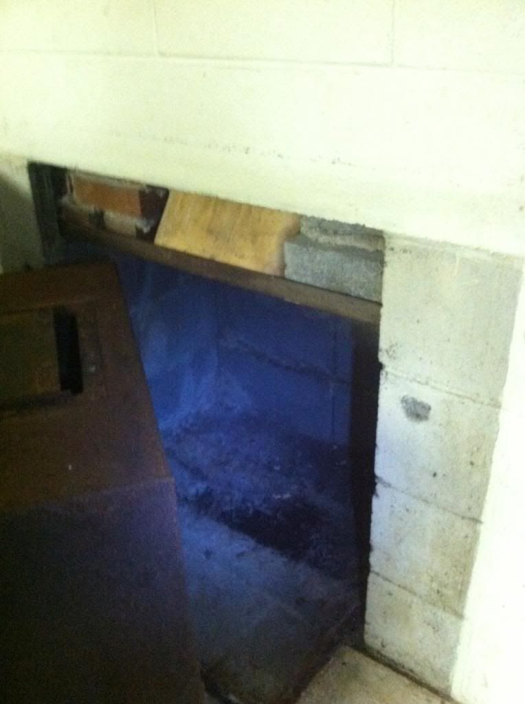

I'm removing this woodstove from my basement and I have a free-standing woodburner that I want to install. I'm going to get the existing flue checked for cracks but I am wondering how I should hook up the new woodburner to my existing chimney. The new woodstove has a 6" round exhaust opening but as you can see from the pics, the existing flue is a rectangular clay and the existing stove looks like it just slid in there and never was fully sealed to the flue. Is there some type of adapter that I can buy or should I run a liner the whole way up the existing flue?

You will need to run a new Stainless liner all the way to the top.
First of all, the pix don't enlarge, so I'm not sure you uploaded them correctly. in answer to your question, it's best to run a liner from an appliance adapter all the way to the cap. A block off plate is advisable, as well. You may need to insulate the liner, depending on what the chimney inspection reveals...
We don't need to know any more about the old insert you're removing. We need to see pics of the fireplace empty, and we need to know all about the stove you're intending to install. Rick

Looks like a lot of water was coming down that chimney.
Running a full-length liner is always preferable; Better draft, easier to sweep the chimney, safer, etc. But you should have a tall chimney and plenty of draft from the basement....may want to install a key damper in the pipe if you re-line.

?? I don't agree. There is a big gap between $400 for a liner and $1400 for a stove and liner. But expauliber, there will be the additional hassle at figuring out how the heck to connect that stove to the liner. It was designed as a slammer with no connection to the chimney. This is illegal now. The damper rod on the outlet is a complication that will require notching the rect. to round flue adapter.

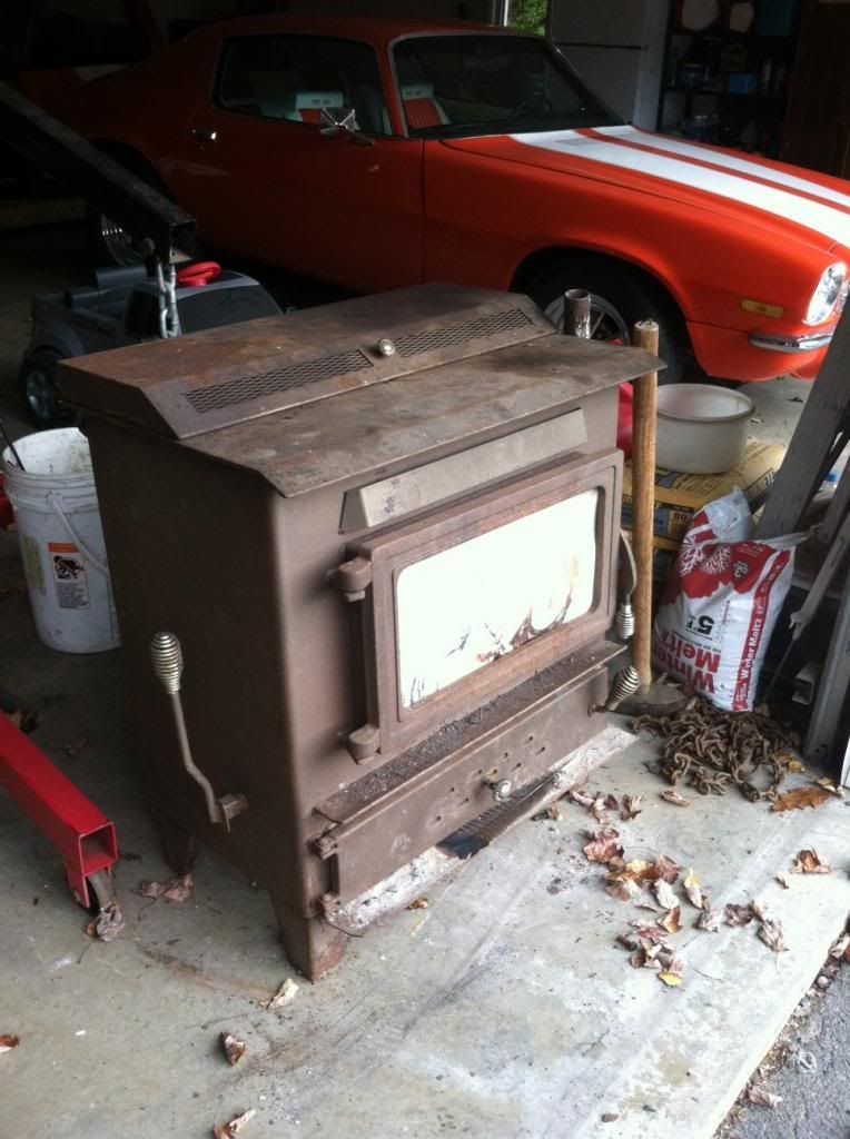

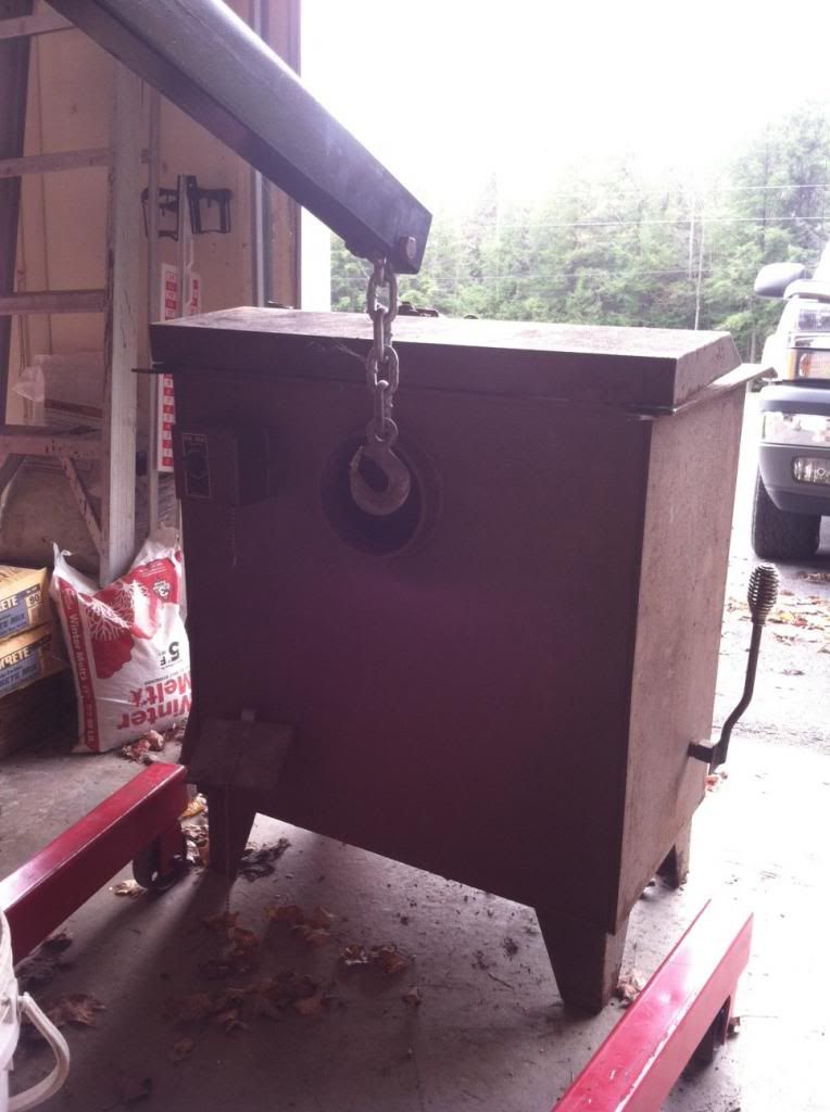

Here is the stove that I want to temporarily install:
[Hearth.com] How to hook this stove up to my chimney?
And here's a picture of where I pulled the old stove out of:

Beefy, Is this a coal stove or it that the overdrive lever on the left side? ==c Is the flue exit 6"?
If so a liner with a capped tee on the end with a short connector (pitched uphill toward the chimney) should do the job.
What are those things on the back? This thing is obviously not going fit under your lintel, so is the hearth deep enough to support it? Do you know anything about this stove you want to install?

Looks like a thermostatic damper to me. I think this is a neglected Hitzer E-Z Flo 50-93 coal stove. Clean that puppy up and put some high -temp stove paint on it. In coal country that might still be worth a pretty penny. But this is not a wood burner.

I got this stove off of a neighbor for $25. He was going to scrap it.
It has a 6" exhaust and my hearth is big enough to support it. I'm in central-PA, the heart of coal country but I don't want to burn coal. Can I install this and just burn wood in it?
I don't think so. It is a hopper fed coal stove. I would fix it up and sell it.
