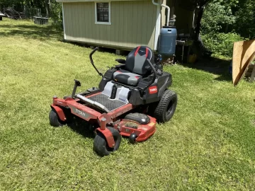

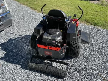

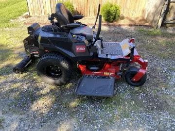

Oops. Sorry. Toro is the brand. Titan is the model.

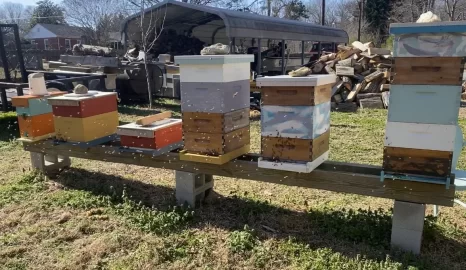

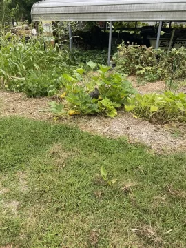

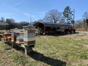

Seriously, the thing about splitter chips is I’ve been doing the munched over garden for a few years. I mostly do wood in the winter right on the garden area, I just leave it where it lays and plant a garden in the spring.
Had to scrounge for some pictures.
