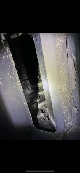

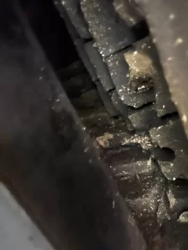

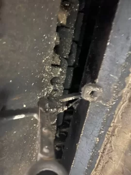

Both of my wood burning fireplaces are non parged smoke chambers made of bricks , built 1965 with flues tiles going up the chimney.
A lot of tar collects on the non parged bricks in the chamber and I had two sweep companies come out and neither clean the chamber brick just the flues
1) how do I get past the damper door because it makes it impossible to get anything up there for cleaning or doing repairs
2) why didn’t builders parge chambers in the past ?

Clean it with a rotary cleaner then suck the debris out from behind the damper. Oh and find a new sweep they only did about 1/4 of the job. As far as parking it I use chamber tech. If it's mixed to the right consistency you can make balls of it and throw it against the wall. It will stick and flatten out. Do that for one coat let it set up and repeat as many times as nessecary. Smooth out the last coat with your hand or tools.

Is that how pro’s do a parging ? I just can’t see getting in there easily , the damper leaves little to no room? I’ve seen a parging trowel look like garden hoe on a stick for smoothing it , also do some companies spray the motar in the chamber ?

Yes I am a pro and that's how it is done by many. There are also spray on options.
