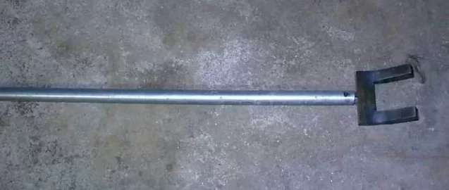

I break them up with my pallet fork, mine is home made but you can buy them.
Then cut them up with a circular saw.
OPE store around the corner put out these nice oak pallets, I grab as much as I can and burn them. :exclaim:

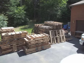

Well, after breaking down 100's of pallets last year, I think I've tried just about every way possible to do it.
BFL (Big F$#^$& lever) - Way too much effort. Those twist nails are like rivets!
Chainsaw - Holding the pallet vertically with a stand and trying to slice down thru the slats. Slats always pinched the bar.
SawzAll - Too slow and weight of the tool can tire one out early. Not to mention the slats will sometimes pinch the blade and vibrate to death...without cutting.
Jigsaw - Did about 50 this way. Aggressive blade. Easy to steer around nails. Barrel grip is easier on the wrist than top handle. Slower that a circular saw, but I get into a rhythm.
Circular saw - Tool of choice using Oshlun Deck & Nail blades. These have more steel backing up the carbide tips, so they can take more "shock" when hitting a nail without dislodging the tip. Sure, they dull but I have the equipment to sharpen them.
I put the pallet on a table with stops (to hold it) and "float" the saw barely above the surface...not really riding on the shoe much. This is (obviously) a 2-hand operation...hence the need for the stops. I use a Milwaukee 6390 because it's one if the lightest saws in it's class. The Tilt-Lok adjustable handle is a plus. After cutting all the slats from the stringers, I cut the stringers with a 10" chop saw.
A spring project will be modifying a Delta Sawbuck to ride on 6ft rails to slice thru the slats without having to hold the saw's weight. Since it's captured by the rails, I'll be able to cut in both directions to save time...without having to worry about kickback.

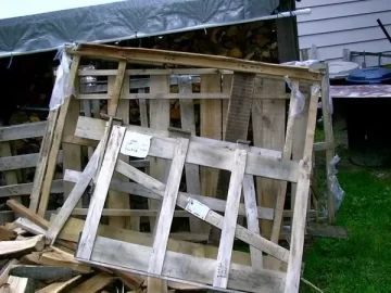

Or, you can do what I used to do and own a friend that runs a pallet shop...
They had to get rid of their scrap somehow, paying for removal if needed (nowadays they chip in and pump the chips into the nearby woods). Once or twice of a year, he'd send a couple of his guys over to dump a huge trailer load at my place. Free wood, but what a pain! Thousands of little pieces from 3" long up to about 2', then hundreds of longer boards with defects that I had to cut to stove length on my band saw. Let me tell you, if you think handling big rounds is a pain, try moving and storing a mess like this before it gets snowed on. Then loading the stove, trying to get a good, long burn (they only work well when mixed with splits in my experience), dealing with the giant bed of tiny coals with no air spaces for burn channels, etc, etc, and so forth.
One year I set up 6 pallets in a rectangle to make a bin. Wired them all together and dumped all the smallest pieces in it. Filled it heaping. Then my buddy's shop went to the chipper and I stopped burning pallet scrap. Now fast forward to last year. I decided to break down that old compost bin that I hadn't been using in years. Forgot all about that it was full of pallet wood fragments, now fully decomposed into about a cubic yard of rotten muck.
God, I hate burning pallets! And getting them deliberately and cutting them up myself? What was I thinking?! My friendly hardware store always has a big stack around the back for free. Every spring I select about 8 good, strong, heavy ones... just enough to store my leftover splits from the recently ended burn season.
