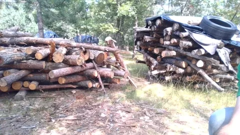

The drying days in my area are limited...snow was on the ground until May this year, and muggy wet summer so i keep all my wood covered, even before processing, piling the logs "criss-cross" so they get some air.
