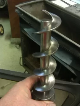

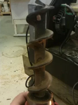

When you get it out ,carefully open it up and repack the gears with some good grease. The factory grease gets pushed away from the gears and isn't doing much lubing. Clean the auger if you go that far. It is a source of a grind or squeal over time. You may need to tap it out from the front. I used a wooden dowel on the auger and tapped it out with a couple of taps with a hammer.
