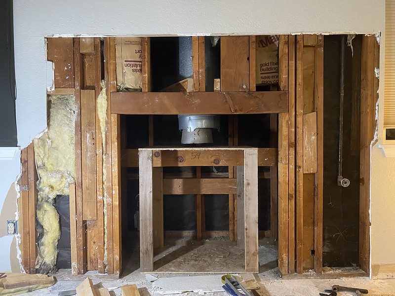

I do not know the brand. It was a gas log firebox. The flu had two pipes. An inner pipe and an outer pipe. Inner was about 8" and outer was a couple inches larger. Unfortunately, we closed up the wall already.
After we cut the pipe from the firebox, we secured the pipes by screwing them into a couple 2x4's attached to the framing and then built a table for it to rest on for more support in the event it drops at all. Then we closed up the wall figuring that was easier than trying to remove the pipes and also may save someone in the future from having to run the whole thing up again.
It wasn't until the next day we realized how far up we pushed the pipe.
Now I just have to rent a ladder or lift and get up there to see. Let's hope it's a twist off. :)
Thanks again.
pic of support we built that shows the pipes

You should have come to this forum first, but that's water over the dam.
Those vent pipes will NEVER be reused. Newer wood burning fire place
use different pipes that are generally brand specific. If you screwed that
venting to the framing members, you are probably not going to be able
to lift the venting any higher than it is. You will probably have to cut the
four "legs" in order to remove the surrounding metal & access any fasteners...
Good luck with your project, & be safe.
