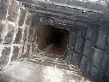

How's the chimney flue look? Good enough for a SS liner with a wood insert?
This view is looking up just past the damper (I put the camera in the damper opening).
Note: In the first tile, there appears to be a crack.
BUT when I zoom in on the photo, it appears to be a manufacturing line of some sort since the end of the clay tile is NOT cracked but solid.
UPDATE: 40 year old exterior chimney -- 25' on this flue -- always wood burning fireplace.
UPDATE: I've attached a photo (compressed with less detail) in addition to the linked photo
FLICKER PHOTO

It looks good. I woulid have it inspected as well. What other details are there? age, etc? Exterior wall?

Ed - updated the original post.

Did it have a flue fire while you owned it? That bottom tile is cracked and I assume it continues to the top. If you put an insulated liner in it you will be in good shape.
