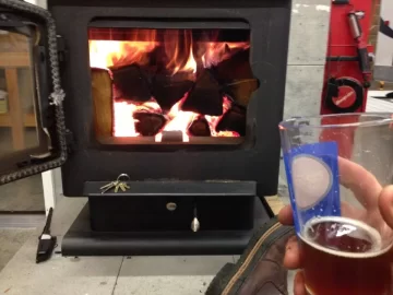

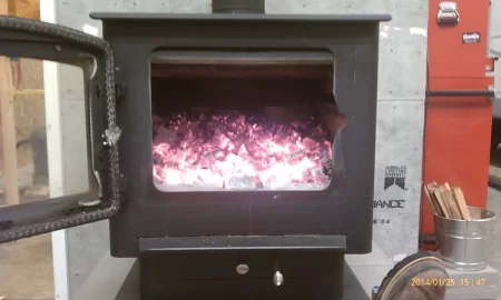

I dare say that anybody who has pushed a stove hard has run into the coaling up problem. Evergreens or hard woods do it. Here's my NC30 looking just like yours.
