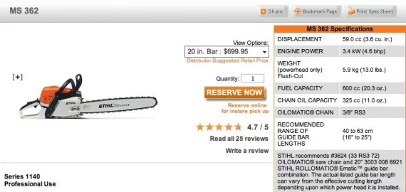

Went thru the which saw before I got mine 2 years ago.
I got the 359 with a 20", good saw but a step below the 357xp.
Now they have the 555 & 562xp & 576xp :
I don't have a brand loyalty so
My thinking though, is if I were to buy a new saw today.
I'd get the MS362 (#1 choice) with a 20"; 2nd would be the 562xp; & 3rd choice is the 555
You may want a 24/25" bar. (MS362 or the 562xp) for that size .
I'd get 3/8 X .050 bar & chain (more chain types to choose from)
I'd stay in the 60 cc area. & 20 ".
I rarely get much cutting over 20", so it's kinda fun when I do & don't feel I need a bigger saw.
The 372xp, is a fine saw. One of Husqy's Icon saws. If you want it , get it. Fairly light weight, great HP/weight, up to a 28" bar.
You have to be happy with what you are using.
I went mid range with the 359, it does everything I expected for a 12 lb 60 cc saw.
When caught up I'll be cutting 8 cords per year. Mid range 20" fits my needs real well !
Some references & specs to help:
[Hearth.com] Huskavarna 372 xp

The 372xp is 0.4 lbs heavier than the ms362. For less than half a pound, id go with 10 more cc's any day of the week for that 20" stuff your cutting.
