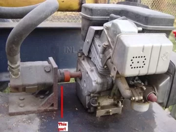

Lovejoy is what connects the engine to the pump. They don't really have a shear pin, but some are keyed (and the key can shear) and some are simply TWO setscrews on each half (one half on the engine, the other on the pump and separated by a rubber "spider"). If the key shears or the setscrews loosen, one part of the lovejoy will simply spin on the shaft.

lovejoy- coupling between motor and pump
[Hearth.com] Huskee 22 ton log splitter not working
Thanks for the picture and further information Jags and blades. I checked the hydraulic fluid as suggested. It reads just below the "needs oil" line on the dipstick. I went and purchased a couple of gallons of fluid at Tractor Supply this evening. Hopefully when I add some tomorrow everything will work perfectly. If not, checking the lovejoy is up next.

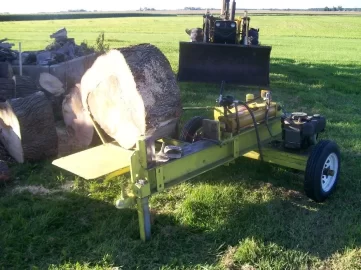

Did your really split that massive hunk of wood in your picture with your splitter? It looks monstrous.
All the time. That is why it is built like it is. Log lift and all.
Turned out to be the lovejoy. Couldn't see it the way the Huskee is built. It's located behind a metal frame under the motor. Had to order both halves and the spider too. Should be in Thursday and its splittin' time again. Hopefully this warm spell will last past then. Thanks for your help.
