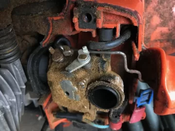

Does anyone have a diagram of how the fuel like for a husky 350 should be routed?

Don't have a drawing, but I have a 350. I guess the route could best be described as "out the top of the fuel tank, through the corresponding hole in the 'air box', loop over the carb support and plug into the carb." Don't know if this pic helps or not, but its a pretty simple route up from the tank, then this little loop.

Thanks
Once I had it cleaned up and started the fuel line replacement it wasn't as hard as I thought
