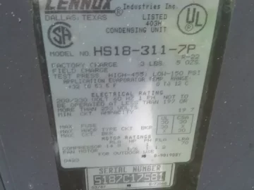

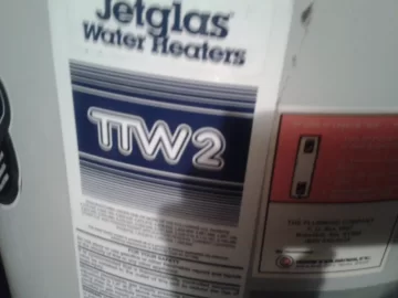

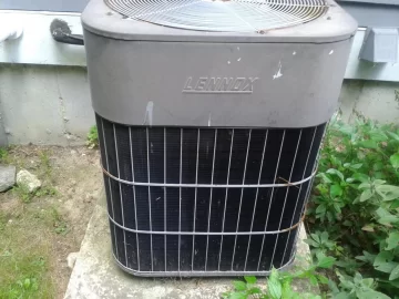

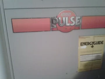

The equipment in question is:
* A Lennox Pulse gas-fired hot air furnace, C. 1988.
I cant get up there to look at it in person but as I remember this is already a very high efficency unit of around 96 AFUE or so. Its direct vented through PVC just like the modern high eff. units.
* A Bradford White Jetglas TTW2 gas fired water heater
* A Lennox central air system, nameplate says HS18-311-7P
Once again, all of this equipment works perfectly right now. She is being told to replace it both by the realtor and HVAC contractor just because its "old".
Thoughts? Am I wrong in thinking its silly to replace this just due to age? Is the $15k estimate crazy or in the ballpark? (put in perspective, the condo is only valued about 200k, and she has already sunk over $10k into paint, flooring and appliances to get it 'sellable')
I asked her to send me some pictures, not sure if you can make out much useful but here goes.

At 25 years old the equipment is coming to the end of service life. The condenser in the furnace should be closely examined for signs of decay. Relays,, blower motors, ignitor etc. are probably going to go soon too.. After having a h/w heater leak, I never push a hot water heater over 15 years now. It is due for replacement. That said, if she wants a quick sale, just price it accordingly or follow BB's suggestion.
sell everything as is. A buyer usually doesnt want the previous owner to replace it anyways, because then they have no ability to chose what to get. sell it with nothing more than fresh paint on the walls. Just plan for what youu want to do when the home inspector finds tons of stuff. fix/negotiate/leave it as is... he will find stuff, jsut plan for what they say.
definitely dont replace working equipment!
Reactions: billb3
I had a Lennox Pulse. That unit is way too old to be safe!. At a minimum she should have the heat exchanger (actually a sealed combustion chamber) pressure tested. Most will fail the test. No new parts are available. Lennox may still have a rebate program toward the purchase of a new system.
Heat exchangers should be inspected during an annual service inspection. If they look iffy, they should be tested for leaks, wearing out, etc.
Most manufacturers worth their salt have an extended warranty period covering this and other parts. Mileage may vary;)
The Pulse is a condensing furnace. It is not an ordinary heat exchanger and not as easy to inspect. Acid corrosion will eventunally corrode the internal exchanger. It's just a matter of time. 25 years is the expected service life.
Yeah this is interesting, I did some Google research on the pulse and the consensus seems to be that it was a radical design that didn't work. Interesting that this one hasn't died yet considering.... Though I have no idea what condition its in and no idea if my MIL actually has yearly service calls done.
Thanks for all the feedback, as I really know nothing of furnaces... Every place I've lived in has been either forced hot water or steam, heck our last rental still had a functional circa 1950 american radiator boiler and the boiler service guys see older than that around here ( coal conversions).. So I never realized these things could die in just 20 years ;)
So bottom line is the pulse probably has to go. The water tank I think should go IF its really leaking, but I'd guess the AC might be OK. Question is does she replace or sell the condo as is and let the buyer replace as they wish. I think the latter is the better idea, and as a buyer I'd want to pick my own rather than get stuck with cheap replacement done in a rush to sell.
