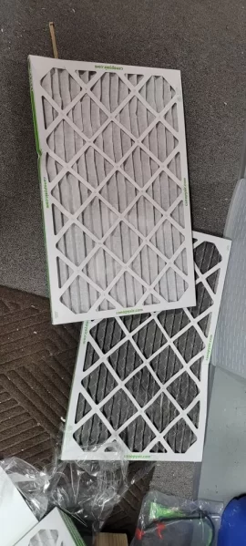

I had a Napoleon EPI3C Oakdale Series Cast Iron Wood Insert installed in September and have been burning wood every day all day since. When the stove is not in use, I have to replace the air filter in my HVAC system once every 3 months. Now, I am finding that I need to replace it every three weeks. Is this normal, or could this be a problem with my installation?
I run the fan in my HVAC system for 30 minutes every hour to try to spread the heat throughout the house. (I have trouble getting the back of the house warm.) I am not particularly good about turning the HVAC fan off when I restock the fire in the morning, and I have to keep the door open a crack for a half an hour or so to give the logs enough oxygen to get a good burn. I think that may be allowing some ash to escape.
Also, my ash emptying technique could improve.
But is this enough to be running through airs filter in the HVAC this fast, or should I get the system checked out?
FYI, I also bought an air purifier for the room. Thanks for the help.

I would back up for a second and look a bit further up in the process. What is causing you to change the filter? Some pressure sensor / warning light? Air flow indicator? Other indication? Changing it just by 'eye' or because it is dark colored? (The last option might not be the best indicator of when to change.)
If you are getting some type of 'sensor' indication to change that often, is the filter media the actual one called for in the system? If you've upgraded to a much higher MERV rating, that could trigger much more frequent changes... especially since it looks to be only a 1" thick filter. Typically a higher filter rating would need greater fan capacity and/or a deeper filter media to give approximately equal filter life and performance.
On the stove side, keeping the door open for half an hour to get a fire going, and worrying about ash coming out seems to suggest a very weak draft. That might also be worthy of an investigation. Flue size / height? Insulation? Last cleaned? Flue cap plugging? Appliances / vent fans moving air out of the house? ..all things to look into.

I'm tipped off about the air filter because my Ecobee thermostat starts "recalibrating" and shutting itself off and turning on again. Checked the Ecobee website and sure enough, a clogged air filter can cause that to happen. This problem has only started since I started using the fireplace.
The installation was just in September, so I haven't had a first cleaning yet. No appliance fans running aside from the HVAC system fan.

Filter has a MERV rating of 8. I just had a new AC installed, and when they did that, they almost doubled the size of the HVAC supply duct, said it was undersized.
Flue liner is about 25' tall, 6" diameter.

Have you actually checked heat register/room air temps in the far parts of the house with, and without the HVAC fan running. Success is normally minimal. At best. Most times it does zero good in my experimentation as the heat is lost in the ducting.
The trouble starting a fire may be explained because you are putting your stove draft up against your HVAC system head to head competing for available combustion air. How well does the fire start when the HVAC fan is turned off? If you still have very slow starts I would naturally suspect wet fuel.
I would not be using the HVAC fan in your setup. No way.
If you need to move air, set a floor fan in the cold part of the house gently encouraging dense cold air towards the stove room for circulation. Mucho safer!
Good luck

Was it installed by a professional? If so that is scary that they ignored this serious safety issue. Again don't worry about the filter the intake needs to be relocated
Yes, the insert was professionally installed. (The fireplace and return were obviously already in place. Also, separate HVAC guys were just here to install the AC and as part of that, they increased the size of the supply duct. Neither one mentioned this.
I personally would go back on them both. This can potentially be a serious problem
