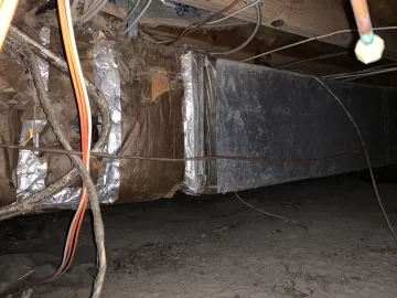

Pictures would be helpful to see what your duct looks like.

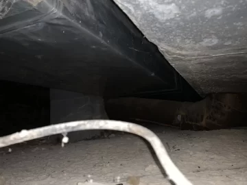

Here they are. Supply is closest. It’s tight . The 4’ closest to the compressor are insulated. Second pic shows the quality of they insulation on the supply duct.
[Hearth.com] HVAC dilemma [Hearth.com] HVAC dilemma
Are you sure the square ducting is not insulated on the inside? That's how it is at my house, built in '68
I know the U turn is not insulated it’s the only part I could touch.
