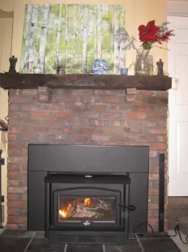

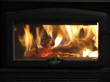

I installed my new Osburn 2400 insert. Man this thing is a beast! Here's some pics of the first fire. Big difference from the Napoleon 1101 I replaced. I love the 1101 it's a great stove, just a little small for my house. Loving the huge firebox of the Oz. The heat this thing puts out is incredible.

Bigger is always better! Enjoy the long load times and the easier morning restarts.
Very sharp unit there!
Great looking install and burn. Enjoy it.

Thanks everyone, I love this thing. Woke this morning 15* outside my door. My drafty house is still at 66 with a thick bed of hot coals. Got a 600* fire going. Temps are climbing real quick in the house. Also, I have since hidden that cord for the fan that you see in the picture. I am very happy with this insert.
Thats a HUGE Firebox for an insert. There are very few things (in my opinion) better for the soul than to wake up to a warm house knowing that a wood fire kept the family comfy all night.

Yeah, agreed 100%, that's the largest beast I could fit in there. It's rated to heat well beyond what my heating needs are. I haven't even fully loaded it yet. I usually load it up about 70-80%, and let it go. And I'm thinking that might be more than I need to be burning. I'm still learning the stove, but it is nice to have too much stove. Especially right now. It's been the coldest week of the winter.
Flame shot looks nice. Belongs in a brochure!!!! Enjoy!!!!!
