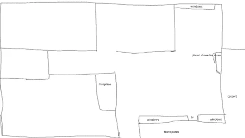

I am getting lots of feedback and am moving closer to the pellet stove. Dealer should be out this week. The stove will have to go up through the roof as stove will back onto my carport. Or that's what I think. So that brings cost closer to wood insert. But Thanks to all the feedback I will be somewhat knowledgeable and more important-have figured out what I want, when dealer shows up. Jean
One of the big advantages of pellet is being able to vent right out the wall. If you have or can draw a plan of your house and post it, you might get some help in rethinking a better locale for the pellet stove to take advantage of horizontal venting.
this is embarrassing but I hope you can understand it [Hearth.com] I am overthinking this--- wood or pellet?
Is the drawing to scale?;)
Reactions: Dave A.
As pellet stoves all rely on forced exhaust going out the side wall and then up through carport roof would be an option. Terminating in the carport would not be a good idea to my way of thinking.
You likely have seen the compressed products just never paid any attention to them. Heck I have even noticed them ( in season of course) in the grocery stores, besides the over priced bundles of campfire wood.
this is embarrassing but I hope you can understand itView attachment 101955
That centrally located fireplace will certainly be a better place than the outside wall for a pellet stove (or any stove). If you end up with pellet, I think it should be an insert.
Also, this is going to be more than just a heat source. NG can do that. A wood burning insert with a nice big window will be a very pleasant experience both visually and from the radiant heat.
As for brand names, you just mentioned Lennox. Their Country line is pretty good. I looked at those myself. It's an old established brand that Lennox bought a while back. You can ask the dealer about their support.
As for size, yes, you can build small fires. I do it all the time. Just keep it hot enough to fire the secondaries and keep the flue above the creosote level. I could actually get away with a smaller stove here. But the Quad Voyager looks to be about 1.8 cf which is not too large.
It sounds like you have the dealer coming out soon, so you will have a better idea of your practical options.
Don't know all the rules, but I guess the idea is that you can't have the stove venting out into the carport because of the proximity to the car which may be considered an ignition source and/or that the carport is too enclosed -- either way not a good idea.
What about moving the stove back a foot or so into (what am assuming is) the dining area a little (assuming your drawing is correct in showing that the carport roof ends at the dining area) and venting out the wall there.

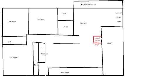

I was so embarrassed I made a better drawing. If I use the fireplace I will use a wood insert because its a focal point and I want to keep the wood option just in case. But I was thinking since I mostly need heat at night wood insert may be better because I would feel safer and it wouldn't be making noise Since the dealer prefers pellet we'll see what he comes up with. Thanks all, my little brain is gonna overload. Hey its 5pm somewhere [Hearth.com] I am overthinking this--- wood or pellet?
