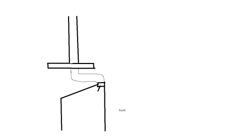

Edit: Though looking at your avatar photo, the fireplace opening looks very small -- especially height -- less than 24"? That might make an install difficult depending on how high it actually is.
It is 26" + from top to bottom but there is 2" slate shelf, so he said they could build up base of fireplace to match. I had thought I could remove or reshape stone shelf . Fireplace is 3' wide and on my reading of measurements it looks like smaller units would easily fit.
I don't know what other dampers look like but this is probably 3" x 10" . If a round pipe is supposed to go from the insert to the top of the chimney I can see how it would have trouble navigating the damper. My last woodburning house had a 1stgen Lopi thats now in Panama with the ex.

The damper almost always has to be removed (sometimes the damper frame too) and sometimes additional bricks knocked out in smoke shelf area (likely in yours with only 3x10 damper to fit a 6" liner through cleanly or the liner can be bent/reshaped -- "ovalized" to fit through). Not usually a big deal for an installer who does these regularly. Damper openings are almost always narrower like that. Mine was about 5" with the damper in place but when I cut out the damper there was about 7" or so-- enough for the od 6.25" liner to get through without too much problem.

That Kodiak looks like a pretty nice option and is large enough for you. This youtube shows an installation using 5" pipe which apparently is allowed according to the manual.
Did you determine whether you can line your chimney be removing the draft?
