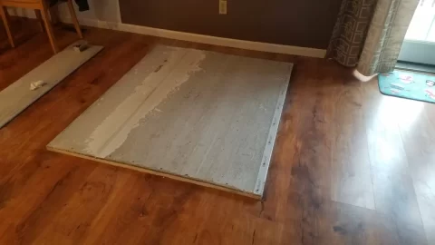

And so it begins....
Plywood and layer 1 of durock down. The Micore is scheduled for delivery tomorrow and I'm headed out to pick up the tile.

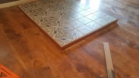

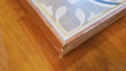

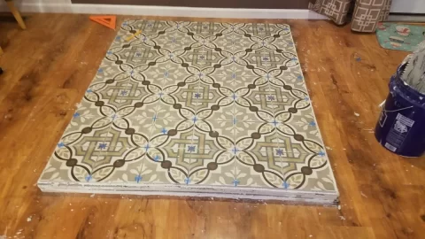

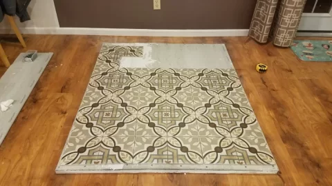

I got my micore today. I got it down with a thin layer of thinset between layers. I also got my tile down with only a few cuts to deal with. Tomorrow is grout and trim. My stove was delayed with the shipping company. Apparently they can't drive a semi down my road so I won't get the stove until next week.
My chimney didn't meet the 10-3-2 rule so I ordered an extension and a roof guy kit. I also gave it a good cleaning. I ordered telescoping stove pipe for the interior. I'm excited to get this done and have my first burn.

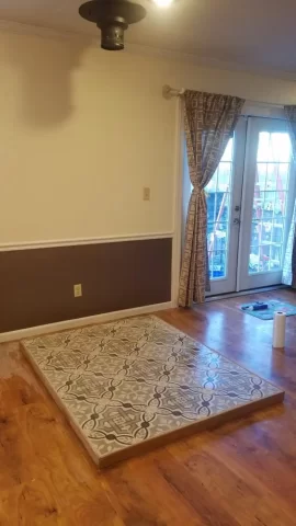

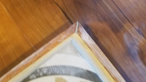

Well I probably won't be taking up cabinetry or tile installation but, for my first time, I think it went well. I'm just sitting around now waiting for grout to dry so I can clean everything up real well.

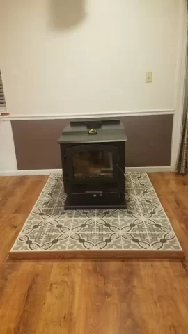

Not sure why the manual calls for anything other than ember protection as the bottom of the stove never gets over room temps but this is a VERY low squatting stove unless you raise it up some how its always pretty close to the floor if not raised up . I have both on my 30s raised about 18in off the floor.
Reactions: Jbeau009
That looks good ,even though the stove doesnt get hot near the bottom ,in front the radiant heat from the door glass is a factor, looks like that pad will take care of it not getting the floor in front too hot and for ember protection.
Reactions: Jbeau009
