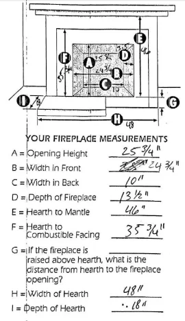

  • [Hearth.com] I cut and split my firewood, now i need a stove! Help!
I think you have a little of a problem there. Your fireplace is not that big and rather shallow. Were you planning on extending the hearth and putting a stove in front of the fireplace or do you want to fit it inside? I think neither the Homestead nor the Castleton will fit. An insert will have the advantage that it will take less space away from the room and exposes only one side to some curious toddlers. You can also put Roxul blankets (available at Lowe's) around it to reduce heat loss to the bricks. However, with a depth of only 13.5 inches you may have trouble to put one in there. Most inserts I know require between 15 and 16 inches of depth. Did your dealer take a look at the fireplace dimensions? Even your first choice, the Craftsbury, should be too high to be placed in the fireplace.
For transferring the heat people here usually recommend putting a small desktop fan on the floor on the opposite side of the house and blow cold air towards the stove room. Reason is cold air is denser and easier to move than hot air. The cold air you blow towards the stove will be replaced with warm air from the stove room and you will get a nice convective circle going. Your plan sounds great but if it does not really work as you envision you will be stuck with a bunch of large holes in your walls.
So...it sounds to me as if you have a nice little Rumford fireplace there. Probably heats pretty nicely when going.
You likely have a very narrow throat and smoke shelf,
If this were my house I'd be investigating options. I'd sure try to preserve that nice little Rumford fireplace.
Any chance of putting glass doors (or a board with insulated back, which can be made to both llok quite attractive and be easily removed when you want to use the fireplace) on that fireplace to preserve heat when not using the fireplace, and putting a stove with new (internal maybe) stainless chimney and stovepipe in the living room, attached to a good freestanding stove? It's rather nice to have the stove where the family spends its time.
That is what I did with my house: drilled holes in the ceiling of living room/floor of boy's bedroom, ceiling of boys' bedroom, floor of lake dormer bedroom/study, ceiling of that room, through attic and out roof. Have never regretted doing so, and has little impact on the rooms it goes through. A small amount of heat radiates from the pipe. but not much. I do get heating through the floor to the room over the stove, to a significant degree, despite having floors that are two layers of 3/4 inch plywood topped with wide board cherry in that room. Even when I keep that door closed, despite being a large. North facing room with lots of windows, the room stays quite comfortable.
Any possibility of putting a stove in the living room instead of the dining room? You could go with a good used stove and use the difference in cost to cover the cost of the chimney, or nearly so.
Reactions: finnski

Have you looked at the Jotul F100 Nordic? I think it's small enough to fit in your fireplace, but probably under powered to heat the whole house.
Sounds like the dining room may not be the best place for the stove, what with the table so close.
And now, with the small fireplace opening, the stove may have to sit further into the room, and even closer to the table?
I'm intrigued by the idea of rethinking the entire plan, and putting a stove in a different room. Like the living room where everyone hangs out.
That opening height is a challenge. This is where Woodstock stoves have an advantage with their low flue exit height. But it still needs about a 26" opening. I'm starting to think insert for this fireplace.
