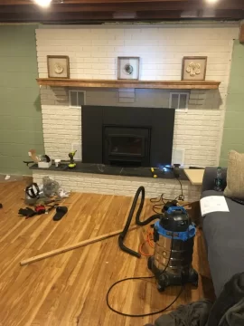

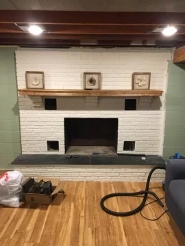

Got the insert in and the liner hooked up , just have to do a final secure of the connections on the roof and time to fire it up!
kinda nervous since I’ve never had an inside stove/insert .... I keep second guessing that I did it all correctly hah

Nice work man, looks very professional, and will throw some heat. What type of insert is it? The only thing I would add, is some sort of an ash rug in front of the stove, you will get poppers that spit out of the stove when opened.

Clean!
Lookin good. It's only missing one thing. FIRE !! :ZZZ

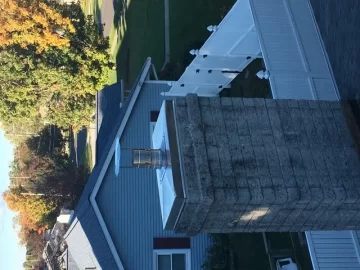

Well first fire was a fail, filled my house with smoke ..... do I have to create a draft ? I can feel the cold air blowing in through the liner
Here’s pics of the top

Is this a basement install?
Draft can be a problem when the temp is not that cold. Roll up a piece of newspaper and make a newspaper "torch" see if that will get a draft moving. What is the temp in PA now? If you sill get smoke, try cracking the door open a bit, sometimes that will help.

I have never done one before this and it honsetly wasnt bad at all, my smoke issue was just a draft issue because ive never had an indoor fireplace/stove. its running now beautifully. Just read read read and ask questions.
its in the 40s right now, once i ran a hairdryer in there it all worked out.
A propane torch can work well too, MAPP gas even better. When it's really cold you shouldn't have this problem.
