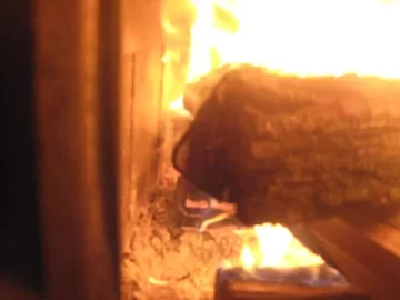

So before I started a little fire tonight at the mrs. request I split a couple of ash splits and tested them with the mm and my small splits measured in at 17 to 20% moisture. So I think Im good to go, well when the wood started to catch pretty good some bubbles started coming out the ends of the splits. This was short lived and totally went away when temps got high. I thought for sure i would be good, Why is my wood doing this? MM has a good battery, im trying to burn good dry wood and im getting frustrated by this. My black walnut did the same thing.

Where was the wood stacked? Have you had any rain recently? I suspect what you were seeing was a little bit of surface moisture, but I am certain others may have differing opinions. I would not worry too much about it provided the wood started fairly easily and burned well.
Yeah "short lived" says the stuff grabbed some moisture from recent rains. Are the stacks covered?

yeah we had some rain this week, the wood is covered by steel roofing. and its stacked in the shade with plenty of wind, wont this make creosote?
you would know if the ash was more than 20%, it would have struggled to burn. It looks like the others have said, some rain or high humidity snuck back in.
How long has it been cut, split, stacked like that?
I agree though, if you were able to get it up to a good temp (500+)easily, that you need not worry about excessive creosote from that moisture so long as your burning habits are good.
The real content of the wood is dry. If it wasn't, you'd struggle getting over 400-450.

Relax, don't worry, be happy...you're doing fine. Burn the wood and keep paying as close attention to everything as you are now. Maybe the wood's not perfect, but it's dang near perfect...a bit of bubbling until up to temp isn't going to fill your flue with creosote and explode into a chimney fire in one burning season (or two). Rick

Short lived bubbling out the ends happens to me sometimes, too. Wood loses moisture out the ends easily, and it will suck up a little too. It doesn't go deep, and you'll be fine. Turn your splits around next time. Maybe the other end won't sizzle.

No worries . . . it happens occasionally even to wood that has been seasoned for a bit . . . now if it had just sat there and sizzled for a good 10 or 15 minutes I might be concerned, but the sizzling stopped, temps were good and a few incidents like this will not automatically choke up your chimney with creosote.
I would be surprised if wood didn't hiss and bubble more, to be honest. Even at 20% MC, that's still 1/5 water!
