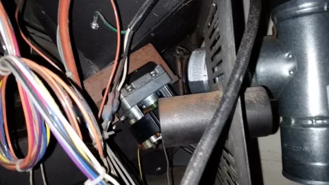

See the attached photos. One shows the fresh air vent pipe leading into the housing on the back, with plenty of ventilation around it to allow in air from the room. The other picture is with one of the side panels of the housing removed. On the right you see where the OAK would attach to the back of the stove. On the left you see where the fresh air inlet would terminate. It's not actually connected directly to the combustion area behind the burn pot. It just sort of points near it.
I'm very happy with my current setup, but with 150 year old windows and doors (and handworked iron door latches that allow in a little air) I feel like I'd have less of a draft in the house in general if I installed a fresh air intake. That's why I'm trying so hard to get to the bottom of this.
I thought of putting some sort of a damper on the OAK where it goes outside (like on a bathroom vent, but in reverse). If I did that, however, the stove would still just pull in combustion air from the room, as there would be no suction to open the damper on the OAK.
Looks like someone disconnected the interior pipe for the OAK. It's 10 years old, but did you have it all this time or did you buy it from someone?
Without knowing that stove itself can you see to the back of the burn chamber from the back of the stove and see if there is something blocking the burn chamber where the OAK pipe should have been?
Some stoves are built that way, kind of a known issue. As to the OAK being open all year, most people block them off in the off season so critters don't get in anyway. I'd be more concerned about if the stove shuts down and having that open hole in the cold weather. I don't see why you couldn't fashion a baffle to close it off maybe attached to a rod ( for lack of a better term, create a choke plate).
Question for you though, where does the stove suck room air in from ? I hope nopt close to the combustion air or you might find yourself heating outdoor air over the heat exchanger.

Enough negativity please- The empress can have a direct connection- get a 1.5 inch metal pipe and hook into the air intake inside the stove housing, fill around with silicone to make airtight, then connect to a 2 inch intake scrunched down with a clamp to make it a positive fitting to the outside air source. Its done all the time with many stoves, not just enviro, some enviros (like the m55) have an intake plume, some don't. I have stoves with no OAKs, but many times they can help.
