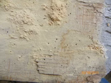

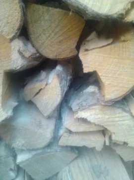

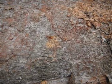

I got a issue with some pine that I have. What is causing this?
Caseihmech
Jan 14, 2013
28
Kennewick, Wa
I was over by my wood pile and heard a noise. So I was trying to figure out what it was and found little piles of sawdust on a small section of wood.
My biggest worry is if I have termites in my wood? Or is it some other bug?
It is only on one small pile of wood and doesn't look like it has touched any of the hard wood that I have.

I got those on my wood pile. Could be carpenter ants, bees? It's mostly on Ash splits. My opinion and I'm not an expert at it but once the wood dries enough and the frost kicks in it should be fine...?
Hard to say from a photo of some sawdust, but whatever it is, will be frozen in November, and roasted in January! Another good reason to not store your wood "in doors".
I know of no termites that live in wood. They live in the earth, and make daily ventures into the wood. Typically, the only thing you can move by moving firewood (unless stored in direct earth contact), would be a few workers. No queen, no sustainable colony.
not termites, more likely sawyer beetle larvae....
Every species of wood that I know of (except for walnut, maybe) has it's own version of borer that will do what is happeing to your wood right now. Nothing to be alarmed about at all, they will put off BTU's just like the wood they are eating when you chuck them into the firebox!
Don't they clog cats though?
He needs to dig all those little bastages outta that wood, and pronto.

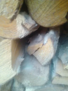

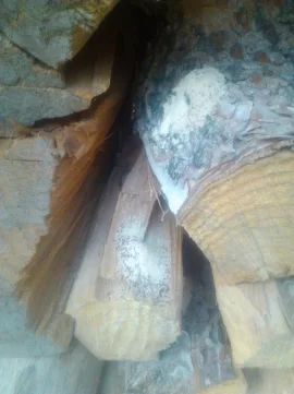

I get the same here in spruce.
Never caught the little buggers but the seem to be gone after winter.
I only see the wood dust the 1st year it's stacked. They don't seem to come back.
I don't see it from splits with no bark.
CSS last fall, the bug wood dust showed up when it got warm. (but when stacked in the shed this Fall, it don't come back the next year)

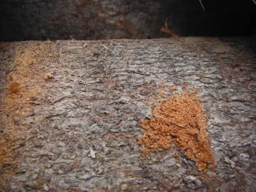

Maybe not enough moisture under the bark after a year of drying. Today's pics:

I had exact same thing with some pine I had stacked, looked just like that and like you said no issues with splits with no bark., It was real wet this last winter/fall and I thought that may had something to do with it as wood was wet
I re stacked under cover and problem seemed to have gone away
Pine has bark borers that will keep munching as long as the bark is on. Usually splitting it and stacking it slow them down. Worse case is strip the bark before cutting (a messy job)

I took the wood that had the bugs in it out to my grandpa's burn pile in his pasture. It was a small section and I am trying to sell the wood that I have, because I am in the process of switching to a pellet stove. I don't think a buyer would like the bugs even if I told them they were not a big deal.
I found out it was a pine beetle. To me they looked like a maggot. It amazed me how many there were under the bark of the splits. One reason why you don't have problems with splits with out bark is because they lay their eggs under the bark.
One thing that I forgot to put in my original post is that I could hear them making noise. You could here them making a clicking/chirping like noise. From about 10 feet away.
Thank you very much for your help. Hopefully they didn't make it to any of my other wood.
