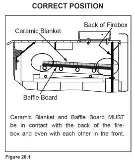

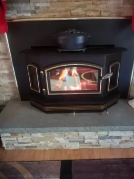

Thanks guys for your replies. I had the guy come here this morning how installed the chimney liner. We got a nice fire burning now for hours it turned out to be the ceramic blanket that goes over the bricks before the flue was bunch up obstrucfing flow. We received it and it's working fine. The guy said i don't need it it's just foe efficiency. What do u guys think. Anyone have this unit that doesn't use it?

That great to find the problem but removing the blanket is a hack. The insulation blanket helps the firebox get hot faster and the stove to burn cleaner. If it is properly installed it will lay flat and not obstruct the flue opening. Put it back in per the instructions in the manual. Look on page 28 for detailed instructions. While you are checking, make sure the baffle board is all the way to the rear.

I agree , i oredered a blanket and will try and install it after the holidays. Do u think it will harm the unit with a low to medium fire. It seems odd that with the bricks in place and the heat going up the flue it would damage the unit? Was hoping to burn a fire for the holidays.
It should be ok. Just make sure the baffle is all the way to the rear of the stove as shown on page 28.
