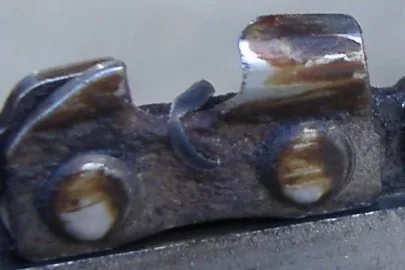

I dropped a 12" hickory and bucked it up yesterday. I started with a freshly sharpened chain. I had to sharpen it once again about half way through (actually should have done it about 1/3 of the way) bucking it up. My saw tore through it while dropping it (big chips, felt it literally pulling the saw through the cut) and the first 1/3 of the bucked logs. Then it just seemed to cut noticeably slower so I stopped and sharpened the chain. I did not notice any damage and was trying very hard to keep it out of the dirt. I don't recall hitting anything but I know I can't see a lot of what is under the log. After sharpening it was ravenous in the wood again, then slowed down after about the same amount of cutting. I had checked the raker height before heading out but the chain is relatively new and they were fine as per my .025 gauge.
One could think I must have hit some dirt or a rock, but this just seems to be my cutting pattern. Everybody else seems to get far more cutting per sharpening than I do. Let me mention one other thing I've noticed. When I go to sharpen it I frequently see a small amount of hardened wood/sap(?) stuck to the top and/or sides of the cutter. My chain doesn't fling oil, probably could use more oil flow, but I at least see a thin coat on the chain whenever I check. Is it possible this wood sticking to my cutter is causing my problems? Could it be a low oil flow issue allowing the wood to stick and impact cutter performance?
I just took these snaps to try and better explain the stuff about wood sticking ot the tooth. Obviously these pics show damage to the cutters. I must be hitting stuff. Man, I really try to not push through into the ground at the bottom of bucking a log. In fact, yesterday the log kept closing on me so I didn't cut all the way through. I had to roll the log and finish with another cut, but this definately kept me out of the ground. Somehow the tooth tells another story, no?
Any thoughts about the degree of wood and junk collecting on my chain? This chain has probably cut up 3 green trees max.

Turn up your oiler, looks like not enough oil to start.
I turned my oiler to the max and left it there, the brown stuff is burnt wood.

You're hitting dirt or rocks or some other abrasive, wahoo. The sure tipoff is that it cuts fine right after you sharpen, but quits cutting aggressively soon after you put it back into the wood.
Try it on another piece of wood that you know is clean--you know, a different tree that's suspended well above the ground. You should get at least at tank out of a sharp chain.
I can see from your very nice pics that you're abrading the chain. Look at the cutting edge on the top rail. It's all dinged up and scratched. When that edge loses its edge, you don't cut.

Along with the great advice given already, get rid of the safety chain. Oregon 91P chain is going to cut slower than non safety chain such as 91VS or it's new replacement the 91VX. The bumper links will slow down the cut. A dull, or slow cutting chain is far more dangerous than a sharp aggresive chain due to the force exerted to get the chain "through" the log.

Perhaps the bark is full of sand; your chain looks like a couple I used on really sandy logs. Those chains would not hold an edge after hand filing, because I just couldn't file enough material off to get back to undamaged chain. The outer layer (chromium I think) is harder than the steel, and that's what holds an edge. If it's gone, you can sharpen the underlying steel but it won't last long. I used the HF cheapo grinder, and seem to have rescued both chains.

Wood fiber is an abrasive. Frozen wood fiber is even worse. Bab's analogy was correct. The harder the substantce being cut, the more it will damage the cutting surface. Plus, anything on or in the wood, like sand or small rocks, will do even more damage to the chain because it's frozen in place, instead of being free to move when the cutter hits it.
I've cut frozen, muddy logs and it's kind of like trying to cut concrete.
Those pictures look like the chain is hitting dirt. I cut frozen wood all day long and my teeth don't look like that unless I make contact with the ground. Frozen wood will dull the saw a little quicker but it doesn't make the teeth look like that unless it is dirty or the saw contacts the ground or dirt stuck to the wood!
Craig
I cut about 75 trees yesterday with MALogger and our chains didn't look anything like that. The only time I see chains like that is when they hit dirt and rocks
I agree. The frozen wood has nothing to do with the condition of your chain. You're hitting dirt or rocks. The only difference the cold weater makes is that if there's mud on the trunk, it acts like a rock.
