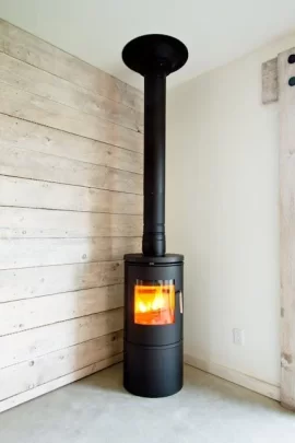

So my inner cave man is happy and warm....I finished the instal of my stove last night. (you don't even want to know how I got 9 feet of chimney up and installed by myself on a 7/12 metal roof! Lets just say there were countless worksite safety guys who kept twitching for some unknown reason yesterday.)
Got her going with a little break in fire this morning.

Looks like it is "stove review" time. It will be interesting to see how that little Morso works for you.

She has been great so far...fortunately/unfortunately it has been pretty warm out so limited "test burns" have happened. But on the couple of below freezing nights I fired it up and it was great.
Didn't overheat us...easy to start (top down works great...found a use for my old hand plane as a tinder maker)...above all that stuff... it's really nice to watch.
Though I do have a strange urge to put on dirty old pants, a wool hat...maybe some gloves with the fingers cut off and stand over it rubbing my hands together!

Yes the glass stays crystal clear...the air wash seems to work well.

Yes..technically you can put a 12" "log" in it...but that is probably pushing it a bit.
I bucked and split 4 cords in 10-11" sections and sure am glad I did as this gives enough room for the air to move around. The few pieces I put in that were longer suffered a bit of sluggishness until I put em diagonal in the box. So, it makes it a great odds and uglies burner as well. I can get tons of that stuff around here for free...probably dump trucks full of it actually.
I know most of you folks cringe at the thought of such small loads, but it is ideal for me actually. I don't want or need overnight burns, My home is small (at least to modern mindsets) at 800 sq feet. I have in floor radiant heat doing the bulk of the work keeping the house at a constant temp. AND!....it means I get to play with fire more often because the firebox needs wood every...45 minutes or so.

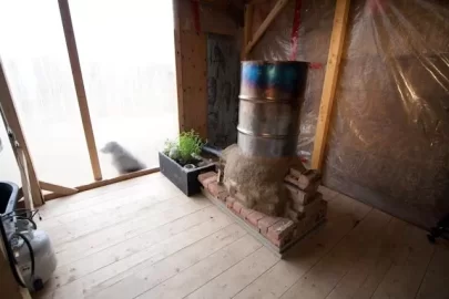

I actually built a "stove" with a 55gallon drum...well it was one of those rocket mass heaters.
Worked great heating my temporary shelter (that turned into a two year temporary shelter) while I built my cottage
BIG though...and I didn't even do the whole heated bench thing and it still ate up a bunch of room, but it kept us from freezing to death.
