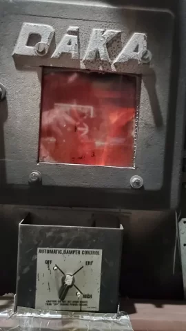

I may have created a hybrid monster.

Started this fire from cold less than 30 minutes ago and the only flames are strictly from secondary burn. This is my 13 yo DAKA ducted wood furnace that this site inspired me to add a secondary burn array to.
This is a site that it never displayed before. Exciting lol...maybe this is what you guys that have dialed in stoves see on a regular basis.

I imagine that'll cut down on creosote production a bit!

What model is that...I don't recall a DAKA with a window?
I added it to monitor burn.
