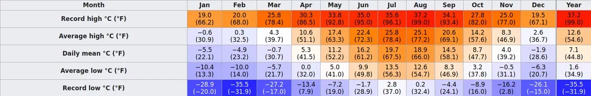

Here our temp data -

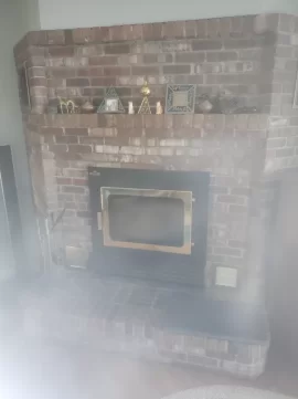

The heating situation is a 25 year old no longer serviceable wood burner (corrosion though the back of the firebox, nut sure if due to leak in chimney, age or misuse but chimney will be inspected and fixed as necessary with new install). It's a Napoleon NM2020 large airtight fireplace with outside air kit and is located upstairs in the main living area with a big brick surround. Sorry about picture quality, phone lens is cracked.
We're looking to replace this with something that will provide primary heat when it's below freezing outside, Nov to March or so. The current unit is large - 36" wide, 22" deep, 51" tall. This is what's behind the bricks.
The support for the chimney is also behind the brick. I won't know how much space is available for a possible alcove install until I start ripping out brick to get the old unit out.

First, to avoid confusion, this is a Zero Clearance fireplace or ZC. An insert is a stove that inserts into an existing fireplace.
There are many very good modern EPA ZC fireplaces that could replace this unit. There are some ZCs that have essentially the same fireboxes as their freestanding models. An 8-12 hr burn is not out of the question in a 3 cu ft unit.
If you want a catalytic ZC, consider the Astria Montecito Estate or some by RSF.
If you want to turn that area into an alcove for a freestanding stove, clearances must be honored. That is often the final determinant.
